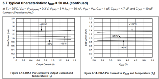

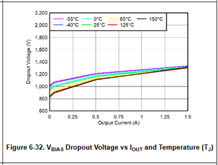

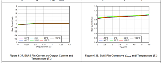

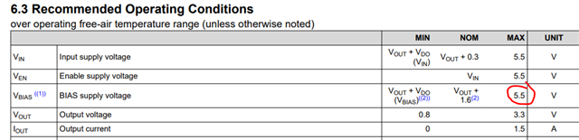

TPS74801: resistor divider to Vbias
Part Number: TPS74801
Hi team,
customer wants to connect 5.7V output through a resistor divider to 5V Vbias pin,
however , we see there's a current sinking at Vbias pin, would you guide us how to pick the divider value,
if we fix the upper resistor at 100ohm, how about bottom one?
