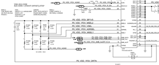

It was already HW setting design in our current schematic.
Since we need to read Vout_mode register for thermal and current information by PMBus.
Can we only change VOUT_MODE[7] and program, then others are the same as previous HW setting  and don’t have changed current schematic for TPS546B24A?
Danny Chin
HW setting in our current schematic:
  • Hi Danny,
    The VOUT_MODE can only be changed through a PMBus command.
    You can keep the same HW schematic, however you'll have to write to the device NVM (EEPROM) to have it hold the setting.
    Let me know if this helps.
    Joseph

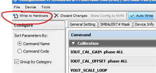

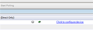

  • Hi Danny,
    Yes, you can do this through the FUSION GUI that I linked above. Once you have downloaded it, you'll need to connect the device to PC running the GUI over PMBus. You can also do this for TPS546D24A.
    When Fusion is open and the device is powered with VIN and connected through PMBus
    1) Select the device
    2) Go to the System View
    3) Click the "Click to configure device"
    4) Under the ALL config tab, find the VOUT_MODE setting
    5) Set to your desired setting
    6)  Click "Write to Hardware" and Store Config to NVM
    7) Power cycle the device to make sure the settings are held correctly.
    Let me know if you have any other questions
