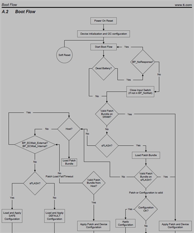

  • Hi, dear.
    Although I see the boot FLOW,  I have a puzzle. Two preconditions as below:
    1.If there is a SPI FLASH and it has been programmed.
    2. ADCIN1 is set to the value between 0.30 and 0.38, the chip will enter the state of Infinite Wait which device infinitely waits in boot state for configuration information.
    When powering up(VIN_3V3 is present), there are two kinds of possible boot flow,  please tell me which is right?
    aaa. Boot from external flash as picture shown below, no use ADCIN1
    bbb. according to the setting of ADCIN1, the chip prior to enter the the state of Infinite Wait and then load the Boot Code and Patch Bundle stored in the FLASH.
     Why I think in this way is that if aaa flow is right, there is no necessary to have the state of "Infinite Wait". You can use either the external flash or Valid Patch Bundle on SRAM
    If VIN_3V3 is present, the PD controller will not boot up in dead battery mode. Hence, scenario aaa will occur. The dead battery configuration, infinite wait, will be ignored. You are correct that infinite wait is not necessary when not in dead battery mode.
