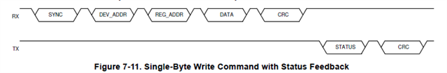

    2. (a). If ACKEN is 1(default), every write command will have Status feedback, which returns FLAG_ERR status and you can know if any fault happens and what kind fault happens.

    We are asked to send read frame to register <FLAG_ERR> and check EEPROM_CRC error and if this error occurred, we should do the following more than 3 times
