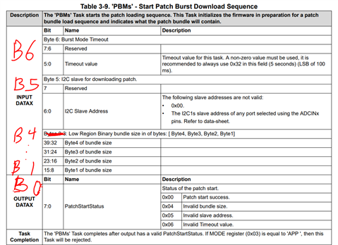

The second question is regarding starting the patch download with the PBMs command, because i figured that I needed to have the address in register 4 and the timeout value in register 5.
Is it correct that the data bundle size should be in register 0-3 or should it be in register 1-3 as register 0 is also used for outputing data after 4CC commands?

    To answer your second question, I have made changes to the reference manual you are using in the image below.
