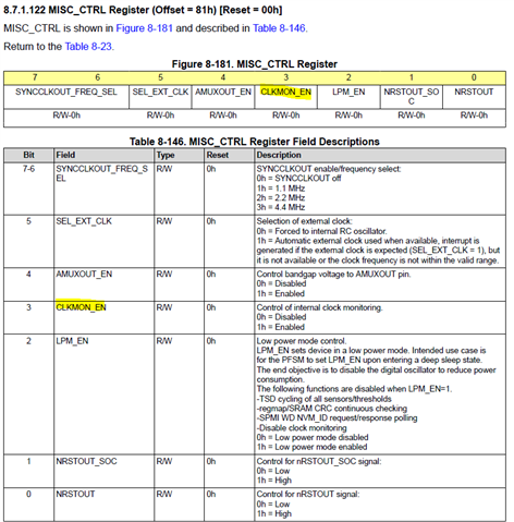

0x48	80h	ENABLE_DRV_REG	0
0x48	81h	MISC_CTRL	1B

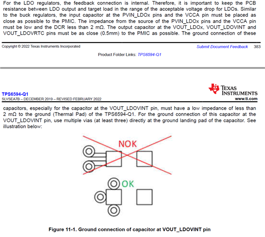

Could you help analyze what errors have occurred in PMIC base on the information above? Thank you in advance.

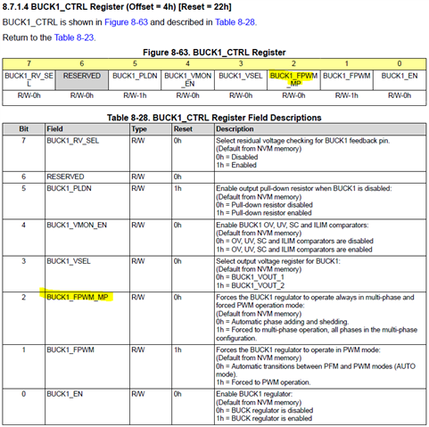

    Register address Register Name normal state abnormal state
    1h DEV_REV 82 82
    2h NVM_CODE_1 11 11
    3h NVM_CODE_2 3 03
    4h BUCK1_CTRL 31 20
    5h BUCK1_CONF 2B 2B
    6h BUCK2_CTRL 20 20
    7h BUCK2_CONF 2B 2B
    8h BUCK3_CTRL 20 20
    9h BUCK3_CONF 22 22
    Ah BUCK4_CTRL 20 20
    Bh BUCK4_CONF 22 22
    Ch BUCK5_CTRL 31 20
    Dh BUCK5_CONF 1B 1B
    Eh BUCK1_VOUT_1 37 37
    Fh BUCK1_VOUT_2 0 00
    10h BUCK2_VOUT_1 37 37
    11h BUCK2_VOUT_2 0 00
    12h BUCK3_VOUT_1 0 00
    13h BUCK3_VOUT_2 0 00
    14h BUCK4_VOUT_1 0 00
    15h BUCK4_VOUT_2 0 00
    16h BUCK5_VOUT_1 41 41
    17h BUCK5_VOUT_2 0 00
    18h BUCK1_PG_WINDOW 1B 1B
    19h BUCK2_PG_WINDOW 1B 1B
    1Ah BUCK3_PG_WINDOW 0 00
    1Bh BUCK4_PG_WINDOW 0 00
    1Ch BUCK5_PG_WINDOW 1B 1B
    1Dh LDO1_CTRL 31 20
    1Eh LDO2_CTRL 31 20
    1Fh LDO3_CTRL 31 20
    20h LDO4_CTRL 31 20
    / 0 00
    22h LDORTC_CTRL 0 00
    23h LDO1_VOUT F4 F4
    24h LDO2_VOUT F4 F4
    25h LDO3_VOUT 38 38
    26h LDO4_VOUT 38 38
    27h LDO1_PG_WINDOW 1B 1B
    28h LDO2_PG_WINDOW 1B 1B
    29h LDO3_PG_WINDOW 1B 1B
    2Ah LDO4_PG_WINDOW 1B 1B
    2Bh VCCA_VMON_CTRL 21 21
    2Ch VCCA_PG_WINDOW 3F 3F
    0 00
    0 00
    0 00
    0 00
    31h GPIO1_CONF 0 00
    32h GPIO2_CONF 1C 1C
    33h GPIO3_CONF 1 01
    34h GPIO4_CONF 3 03
    35h GPIO5_CONF 20 20
    36h GPIO6_CONF 20 20
    37h GPIO7_CONF 10 10
    38h GPIO8_CONF 0 00
    39h GPIO9_CONF 1 01
    3Ah GPIO10_CONF F8 F8
    3Bh GPIO11_CONF 1 01
    3Ch NPWRON_CONF 19 19
    3Dh GPIO_OUT_1 4 00
    3Eh GPIO_OUT_2 4 00
    3Fh GPIO_IN_1 4 00
    40h GPIO_IN_2 0C 08
    41h RAIL_SEL_1 0A 0A
    42h RAIL_SEL_2 A2 A2
    43h RAIL_SEL_3 6 06
    44h FSM_TRIG_SEL_1 1E 1E
    45h FSM_TRIG_SEL_2 1 01
    46h FSM_TRIG_MASK_1 51 51
    47h FSM_TRIG_MASK_2 55 55
    48h FSM_TRIG_MASK_3 15 15
    49h MASK_BUCK1_2 0 00
    4Ah MASK_BUCK3_4 0 00
    4Bh MASK_BUCK5 0 00
    4Ch MASK_LDO1_2 0 00
    4Dh MASK_LDO3_4 0 00
    4Eh MASK_VMON 0 00
    4Fh MASK_GPIO1_8_FALL FD FD
    50h MASK_GPIO1_8_RISE FD FD
    51h MASK_GPIO9_11 3F 3F
    52h MASK_STARTUP 11 11
    53h MASK_MISC 2 02
    54h MASK_MODERATE_ERR A0 A0
    0 00
    56h MASK_FSM_ERR 0 00
    57h MASK_COMM_ERR A0 A0
    58h MASK_READBACK_ERR 9 09

    I check the layout and placement of the LDO_VINT cap. As the limitation of actual layout, the placement of the LDO_VINT cap can not completely meet the requirements of guideline. So we cannot rule out the influence of LDO_Vin cap until now. It maybe a direction.

    Q1: You mentioned there may be a digital reset if the placement of LDO_VIN cap is wrong. And you also mention the increased load of TDA4 and increased noise could be the reason. Is there something related?
    In other words, if the noise of Buck increases, can it directly lead to a digital reset? Or the buck noise increases → LDO noise increases → digital reset?
    We would like to know if it is a combination of two factors. Or just a seperate factor that has no correlation and each can lead to this issue.

    Q3: To confirm for your answer to the last Q3. I'm not very clear. You mean if we set CLKMON_EN=0, then PMIC_B(?) will not shutdown if a digital reset happen?
    Q4: Setting BUCK1_FPWM_MP=1 may reduce the noise. We only need to set buck1, not care buck3 and others. Can all the buck follow buck1?

  • Q1: You mentioned there may be a digital reset if the placement of LDO_VIN cap is wrong. And you also mention the increased load of TDA4 and increased noise could be the reason. Is there something related?
    Increased load on TDA4 means larger load transient events on CORE and CPU rails  --> Larger transient events means more phase shedding and adding --> more noise caused by bucks --> increased noise on LDO_VINT and internal clock --> increased chance of digital reset.
    So it is a combination of the two factors.
    PMIC-A is experiencing a digital reset not PMIC-B. PMIC-B powers down because it lost communication with PMIC-A. Execute the write on PMIC-A and see if it still experiences a digital reset.
    On the primary phase on the multiphase rail needs to have this bit set. The other bucks in rail will follow.
    Q5: Is there any potential reason for digital reset? Just would like to learn more if you have more experience and ideas to share.
    Glitches on one of the monitored internal clocks is the primary reason for the digital reset. LDO_VINT powers these clocks, so noise on the LDO can negatively impact the internal clocks.

    Q4: You mentioned there will not a shutdown if we set CLKMON_EN=0. What influence would this lead to if we could solve the shutdown problem by it? Any other ideas you can share and let us try?
    With the clock monitor disabled, the PMIC will not react to glitches on the internal clocks/oscillators. If a shutdown does not occur, this means that any noise getting into the PMIC is likely very small. If a shutdown still occurs either there is a lot of noise entering the PMIC or there is a different cause for the problem.

    I made two modifications for both PMICs: one is to set BUCK1_FPWM_MP=1, and the other is to set CLKMON_EN=0. The result is also shared with you. We made this change last Friday and the abnormality has not recurred until now. According to the previous frequency, it should appear once a day or once every two days.
    I have to confirm with you for more details. I think we can  set BUCK1_FPWM_MP=1 and treat it as a configuration optimization. However, can we set CLKMON_EN=0 for our ECU. What I mean is does it bring any other issues or potential risks?

    The issue can be resolved by disabling the clock monitor on both devices (CLKMON_EN=0). Please see the the last few posts of this E2E thread for explanation:
