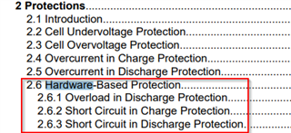

    It is correct, it looks like OCD is FW protection in the BQ28z610. Any FW protection can delay up to 1s plus the programmed delay time. Hence, it is normal what you are seeing.
    The device also offers HW protections which can be used. See below
