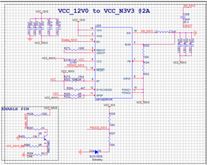

I am using LM61480 to generate -3.3V from 12V of load current 4A. Inductor part Number - IHLP2525CZER2R2MA1. Kindly find the attached Schematic for review

1. Please review attached updated schematic.
2. I will not connect PGOOD output signal to any of my external Component.So, please let me know just a pull up alone is sufficient there are not instead of level shifter circuit?
3. Please let me know the functionality of SPSP pin.
Thank you.
1. Schematic looks okay.
2. Are you trying to just measure the PGOOD flag with respects to the IC in this case? If so then this should be fine. However, if not then it will need be to level-shifted to system ground if they are to be utilized by the system.
3. SPSP pin is to enable/disable the spread spectrum feature for improved EMI performance. Please refer to Section 8.3.10 for more details on the spread spectrum control.

Unfortunately the LM61480 WEBENCH designer tool does not have the IBB simulation capability.
Please follow the IBB conversion design app note (https://www.ti.com/lit/an/snva856b/snva856b.pdf).

I was wondering if you can tell me if the LM61480 is working in IBB mode for you? I just received a board using the LM61480 (20V to -4.7V) and it is not working correctly. Wondering if yours is. output on our unit is -19V
I see on Rboot/Cboot you do not have a capacitor to SW. Is this intentional? if yes would you be able to tell me what documentation indicated to remove this capacitor? Other than that My schematic looks similar to yours.
