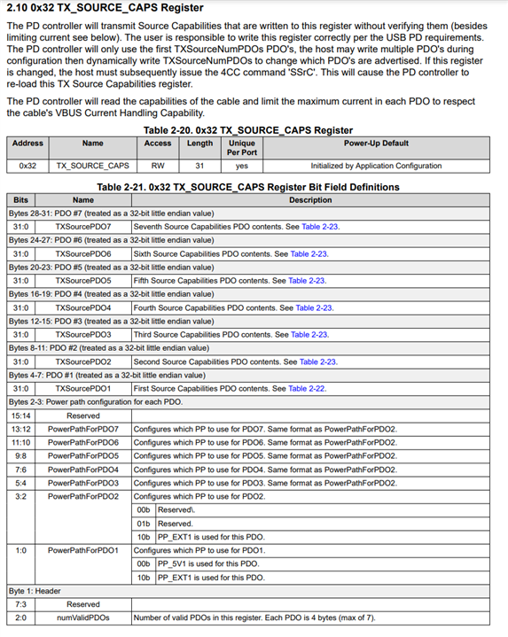

If I understand correctly, for a sink/source configuration (default in the config tool, as shown below), then the 5V/3A PPO is sourced via the 5V regulator, and not from the BQ. Is there a way to change this in the configuration tool? I can still have 5V attached (supplying up to ~1A), but in our current design our 5V regulator cannot handle the total worst-case current draw, whereas the BQ has access to the cells in the pack. This would simplify our design if we could just always use the BQ for sourcing output current.

    Yes, this is possible by switching the 5V 3A PDO power path from the default PP5V to PP_EXT. This would be done in the 0x32 TX Source Capabilities Register. While this capability is supported by the TPS25750, it is not currently supported by the web GUI.
    To change this setting, you would need to use an embedded controller EC to write to the 0x32 TX Source Capabilities register with the correct data bits.
    Byte 2, bit 1:0 should be set to 10b (PDO1 is the 5V contract). This would set PDO1 to use the PP_EXT1 power path which connects to the BQ part on our EVM. This would need to be written to register 0x32 on the PD controller along with the proper PDO1 contents as specified in the technical reference manual available on ti.com.
    Note: All PDOs above PDO1 can only use PP_EXT1 power path running through the BQ part. That being said, using PDO1 is still mandatory for boot up.

    However, we tried that today, and were unable to get that to get it to work. We tried the following:
    Solution 1) Write to register 0x32 to adjust PowerPathForPDO1 to 01b, and then send the 'SSrC' command. At that point, the device failed to be detected by our USB-C load.
    Starting over:
    Solution 2) Adjust PDO1 to 1A max, and add another 5V PDO at 3A (as any later PDOs will automatically source from PP_EXT1). The load detected the device, and the new PDO appeared in the list, but selecting it caused the TPS to reset.

    Are you using TPS25750D or TPS25750S? The D version has two internal power paths while the S version has one internal and one external power path. In the D version TPS25750D, you cannot change the PDO1 power path to source through PP_EXT1 even by writing to the register. PDO1 must use PP5V. For the TPS25750S, this is possible.
    I consulted with the team about using two 5V PDOs, with PDO1 being 5V through PP5V and PDO2 being 5V through PPHV or PP_EXT1. However, this is not allowed by the PD controller firmware.
    Please check if you are using TPS25750D or S.
    Alex
