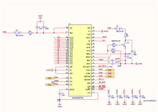

 HI, SIR,
     We  use  bq76952   to  read  temperature sensor  as  following.
    #define DFETOFF_TEMPERATURE 0x6CU /*DFETOFF温度读取命令*/
   #define TS1_TEMPERATURE 0x70U /*TS1温度读取命令*/
  #define TS3_TEMPERATURE 0x74U /*TS3温度读取命令*/
 #define DCHG_TEMPERATURE 0x78U /*DCHG温度读取命令*/
 #define DDSG_TEMPERATURE 0x7AU /*DDSG温度读取命令*/
 For  a  long time   the  temperature reading  is  normal.  But  we  see  sometimes,   the  temperature  is  abnormal,   for  example   the  real  temperaure is   40℃, but we  get 96℃.
Power   off  bms,  then power on  again,  the temperature is  40℃
  • Dear Jian,
    Please correct me if I am wrong, but it seems like you have set up 5 thermistors on your device. This leaves me with a few questions that will help me understand the situation better:
    1. Are all 5 thermistors seeing the wrong value at the same time or does one produce the proper value while the other 4 produce incorrect values?
    2. Do the proper values ever reappear after going high or does it only go away after restarting the device.
    3. Can you share your configuration of the temperature sense pins like the Settings:Configuration:TS1 Config register?
    4. Could you share the hardware set-up of your thermistors? Is there any capacitors in parallel to the thermistors and what type of thermistor are you using?

  • Dear Jian,
    You're configuration for the pins looks like it should be fine. However, I wanted to double check that the thermistors are off the board of the schematic shown and mounted near the battery and that's why the capacitors are only showing to for the pin inputs.
    When these changes in temperature occur, is there a significant different on the pin voltages? It would be helpful to know whether the corresponding change in temperature correlates to a change on the input pin voltage to determine whether the issue is on the hardware or software side.

  • Dear Jian,
    Thanks for sharing the thermistor with me. Nothing about it seems out of the ordinary. I am curious about the situation where the 96C temperatures occur. Could you clarify what exactly is happening? Is the temperature staying exactly at 96C or does it vary and change with time? For example, would applying external heat to the thermistor produce any change on the measurement when it is stuck at 96C?
    I would recommend checking the voltage at each thermistor pin when these 96C temps are being recorded to see if an abnormal voltage is on the pin when compared to the normal readings after restarting the device.
    AsherNederveld

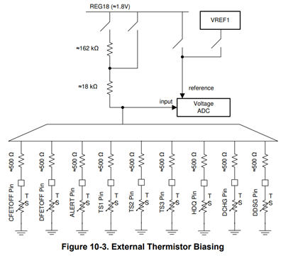

  • Hi Jian,
    If you're seeing ~10-20mV across the NTCs, this makes me think that the 180kohm internal pullup is being used for the pins.
    Are you seeing this low voltage at all times? Or just during the fault?

  • Hi Jian,
    See the image below for a diagram of how the pins function internally. You won't be able to raise the voltage from the pin since the 1.8V REG is the only pull up voltage available, and the 18kohm option is already selected.
    Your software configuration should be fine, however, another possible test that you may try is using the example code provided on the product page to see if that has any effect on this behavior.
    Max Verboncoeur

  • Hi Jian,
    The TS pin works by periodically sourcing current on the pin, and simultaneously reading the voltage dropped across the external thermistor. Depending on how you are taking these measurements, the pulse may be too quick to read.
    Can you send the raw ADC temperature readings? You can find the registers to get these values from Section 4.6: Subcommands 0x0075–0x0077 DASTATUS5–7(), Additional Measurements of the TRM.
    Also, don't have anything extra connected to the NTCs (i.e. meters/probes) when taking these readings as too much capacitance on the pin could interfere with the measurement process (the 470pF capacitors should be fine to leave as they are).
    You may also send your .gg config file so that we can check it.
