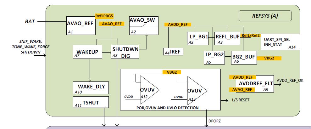

Hi Chase,
For the 79600, for below OVUV block, the OVUV can work in active mode , sleep mode and shutdowm mode?
Which modes of three OVUV work or all the three modes OVUV can work?
David
Hi Chase,
I mean the block A12 and A13, operation in ACTIVE and SLEEP mode?
Why need to work in SLEEP MODE?
