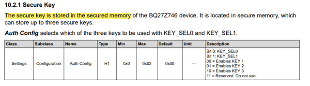

Learned from TRM that the Security key is stored in the Security memory. There are a few questions:
1. Is the Security memory Flash? Is it possible to modify the key multiple times?
2. After writing the Key to the Security memory, how to verify whether the writing is successful? Is it possible to read back the key in the Security memory?
