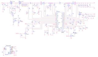

I am considering using the BQ25730 charge controller for a design which will utilize a single cell (1S) or dual cell (2S) li-ion battery pack (8000-12000 mAhr) cell.
This device was selected because it has a number of advantages to delivering a flexible solution for high current charging and NVDC architecture.
The charger circuit must be able to negotiate USB-C Power Delivery up to 20V/3A in order to rapidly recharge the battery.
The system load is 15W nominal, 20W peak (<500 mS) and the power-path must be able to keep the running without interruption while initiating charging profiles.
The battery is fed through to a boost converter power supply (12W) for driving a load and a LDO (3W) for powering low-voltage electronics. The maximum input voltage to the boost converter is 13V and the LDO is 18V.
I have created a design based on the EVAL board schematic (*FYI the USB-C port is not configured correctly*).
Questions:
  1. Based on this application is the BQ25730 the most ideal choice with minimal component count/cost? There are quite a few components required and would prefer something with less parts.
  2. What additional hardware is required to negotiate USB PD profiles for the UFP with the DFP?
  3. How is the output voltage configured with NVDC such that the output is the same voltage as the battery even while charging with up to 20V input?
  4. Is there any reference design which might be helpful at illustrating this functionality?
  5. Please check design below for any errors/recommendations.
  6. The EN_OTG signal is not needed because the device is not ever acting as a host.
  7. I am not certain CMP_IN is required/needed. Can someone clarify the functionality of this pin?
  8. Are there any additional parts which an be removed that were carried forward from the EVM?
  9. Any other design / layout considerations?
Any guidance is extremely helpful. Thanks in advance!
