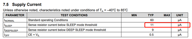

Hi team,
Could you please share the max value of Isleep? Why is only the typ value given here, is it because the max value changes greatly? If so, what is the range of change? Thanks and look for your reply!

Hi team,
Could you please help on this? Because our customer need this value to do device management and report. Thanks!
Hello Kailun,
In sleep mode, the gauge wakes up every 20s (I may not have the exact number here) and performs computations. So there is peak consumption at this time. Depending on whether or not a simulation is performed the peak itself can vary and the total time of the peak can vary. Therefore it is not practical nor useful to provide a peak number.
