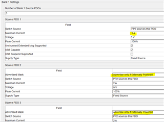

I can't get the option Advertise only if Externally Powered to work. I'm using two TPS65987EVM evaluation modules:
  • One called Host: EVM with the default out of the box configuration
  • One called Device: EVM that is optionally externally powered, custom configuration. Dual power role, default role is sink, Barrel Jack Detect Event is enabled to make it a source when externally powerd.
My Transmit Source Capabilities are as follows (0x32):
  • Without an external power supply, only PDO1 is advertised. The settings 5 V, 0 A for a sink only should be in accordance with USB PD 3.1 specification (section 6.4.1.2.2)
  • With an external power supply (20 V), PDO2 to PDO4 should also be advertised. But they aren't. Only PDO1 is advertised (which leads to a CapabilityMismatch during PD conctract renegotiation because of the 0 A). And it doesn't matter if the Device is externally powered before or after the USB-C connection is established. The Barrel Jack Detect Event is triggerd, since the Externally Powered flag is set properly.
There's a different way of changing configurations described in slvae11a section 3.2 which is much more complicated. I've not tested it yet, because I would prefer the simpler solution (because of KISS: "Keep it simple, stupid!")

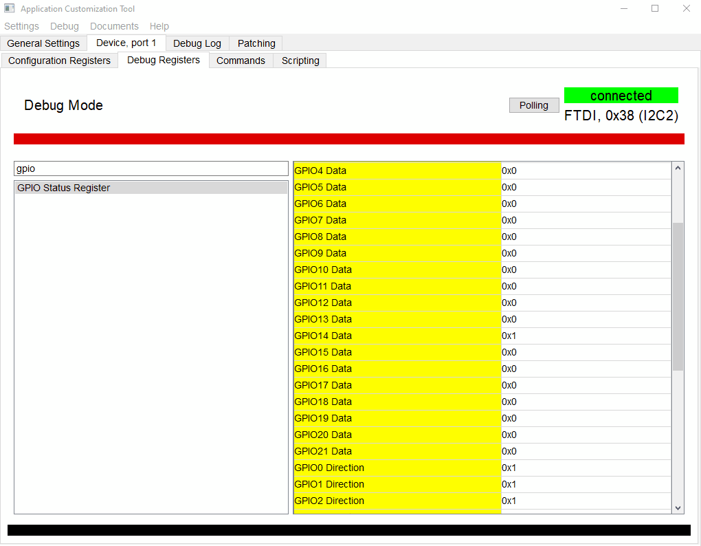

  • I see you have the Barrel_Jack_Event input GPIO configured for GPIO21. Are you able to confirm that this input is rising to logical 1 upon barrel jack plugin and that the dead battery flag is being cleared? (You can see this in the Debug mode or using a scope).
    Are you also able to get the PD negotiation logs? I want to see the source capabilities that are sent and the requested PDO from the sink.
    Kind regards,
    Conner Gillette

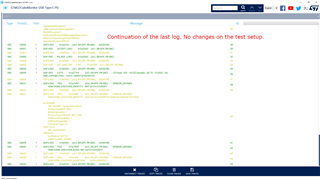

  • Hi Conner,
    I checked the PGOOD signal with a scope. It becomes logic high when I apply external power.
    The dead battery flag is TRUE when there is no external power. It becomes FALSE when I switch on the external power. The Extermally Powered Flag also changes from FALSE to TRUE.

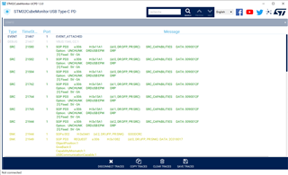

    I'm using a devboard (USB Type-C and Power Delivery Discovery kit) to get the PD negotiation logs. I'm not sure how helpful this is. But here is logfile:
    • I changed some of the PDO settings in the meantime but the outcome is always the same.
    • The Host is externally powered, the Device is not.
    • I plug in the USB cable and the Device becomes the power sink
    • I plug in the external power supply of the Device and it issues a PR_SWAP (line 80).
    • The advertised PDO is still only [1] Fixed : 5V - 0A

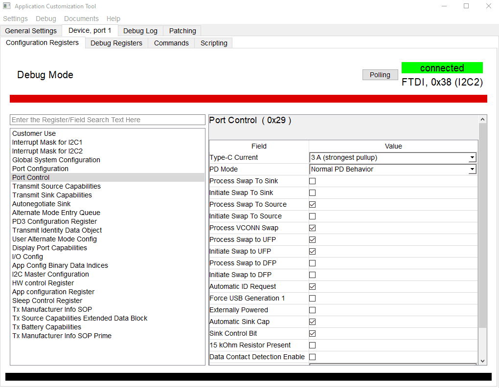

    Field
  • Hi Florian,
    Using a python script I developed to determine the differences between the two snapshots, I was able to develop the corresponding documents which state the discrepancies between values/registers in the documents you gave me.
    • Device_Diff.txt  --- This is the difference between the < snapshot_device_ext_powered.txt > and < snapshot_device_ext_unpowered.txt >
      Unpowered values: Port Configuration (0x28) - (0x1dfb61800)
      Powered values: Port Configuration (0x28) - (0x1dfb61802)
      Line #: 183
      Unpowered values: Port Configuration                           UFP (0x0)
      Powered values: Port Configuration                           DRP (0x2)
      Line #: 185
      Unpowered values: Port Control (0x29) - (0x313442)
      Powered values: Port Control (0x29) - (0x393442)
      Line #: 209
      Unpowered values: Externally Powered              False (0x0)
      Powered values: Externally Powered              True (0x1)
      Line #: 227
      Unpowered values: PK♥♦¶oF☼WZ☻▲]E´E´"DI Box, port 1 Debug Registers.txt
      Powered values: PK♥♦¶šF☼W¥µx    ¢´¢´"DI Box, port 1 Debug Registers.txt
      Line #: 1058
      Unpowered values: Status (0x1a) - (0xe0001d)
      Powered values: Status (0x1a) - (0xe0003f)
      Line #: 1405
      Unpowered values: Conn State                 Connection present, no Ra detected (Rd but no Ra) or Rp detected with no previous Ra detection, includes PD Controller that connected in Attached.SNK. (0x6)
      Powered values: Conn State                 Connection present, Ra detected (Rd and Ra detected) or Rp detected with previous Ra detection (assumes PD Controller started as Source and later swapped to Sink). (0x7)
      Line #: 1408
      Unpowered values: Port Role                  PD Controller is Sink (C_CCx pull-down active) or port is disabled/disconnected. (0x0)
      Powered values: Port Role                  PD Controller is Source (C_CCx pull-up active). (0x1)
      Line #: 1410
      Unpowered values: Power Path Status (0x26) - (0x80000000c0)
      Powered values: Power Path Status (0x26) - (0x4000000400)
      Line #: 1422
      Unpowered values: PP1switch               PP1 switch enabled (system input). (0x3)
      Powered values: PP1switch               PP1 switch disabled. (0x0)
      Line #: 1426
      Unpowered values: PP2switch               PP2 switch disabled. (0x0)
      Powered values: PP2switch               PP2 switch enabled (system output). (0x2)
      Line #: 1427
      Unpowered values: PowerSource             Dead Battery flag is set (PD Controller is powered from VBUS). (0x2)
      Powered values: PowerSource             PD Controller is powered from VIN_3P3. (0x1)

      Unpowered values: GPIO Status Register (0x72) - (0x12c00700000002)
      Powered values: GPIO Status Register (0x72) - (0x12c00700004002)
      Line #: 1852
      Unpowered values: GPIO14 Data        0x0 (0x0)
      Powered values: GPIO14 Data        0x1 (0x1)
      Line #: 1868

  • Hi Florian,
    After diving through again, it appears that GPIO21 may not be high for either device when the device is 'externally powered', but believe this only pertains to the 'usb_device'.
    Could you ensure when you are doing this/externally powering the device, that you are driving this pin high? This may have some effect here.
    What could or may not help, can you go into the ACT and go to the tab labeled 'Port Control' and select the box for 'Externally Powered' and seeing if this helps? This is currently selected for the usb_host, but not for the usb_device. The following .bin file should also have this change implemented (and only that), but if it does not work feel free to do the above implementation I described. https://e2e.ti.com/cfs-file/__key/communityserver-discussions-components-files/196/usb_5F00_device_5F00_advanced_5F00_edit.bin
    Field
  • Hi Field,
    thanks for your answer. You are right with your observation about the state of GPIO21: it doesn't ever change. I captured the ACT in debugging mode as an animated gif (don't know if ithe animation will play). GPIO21 Data stays at 0x0 while Externally Powered in the Port Control register changes accordingly when switching the external power supply. I also followed your recommendation to set the Externally Powered bit to 1 in the configuration file which didn't help. Apparently it changes dynamically to represent the actual status of the system. Any preset value is overwritten.
    The last two screenshot show the voltage at GPIO21 and of PWR_SYS just to ensure the hardware works as intended. And for me it looks OK: GPIO21 follows the external supply voltage.
    Florian
  • Hi Florian,
    Yes, as I figured but was worth a try. I don't know why GPIO21 is not high, but it obviously responds accordingly as even in those debug files the device tested as 'True' for being externally powered. And based on your oscilloscope it is also high and the device reacts accordingly.
    Using two EVM's it looks like I was able to get 0.9A advertised after making some changes, but nothing more than this with the PDOs being set to 3A, including this one..

  • Hi Florian,
    It is much appreciated Slight smile
    After some tinkering it looks like I was able to get the 'Advertise only if Externally Powered' to work using and configuring a fresh project or using some changes to your usb_device project as well:
    Please try the following .bin file: https://e2e.ti.com/cfs-file/__key/communityserver-discussions-components-files/196/8686.usb_5F00_device_5F00_advanced_5F00_edit.bin
    Field

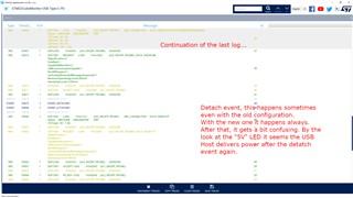

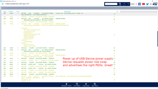

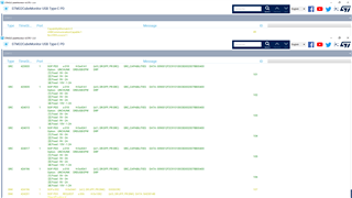

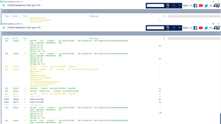

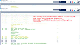

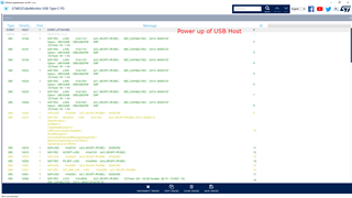

  • Hi Field,
    thanks again for your help. Unfortunately I got sick last week and couldn't test your bin file.
    I've tested it now and can confrim that the advertising of the PDOs works! But there's still something wrong. The actual role swap seems to last only for a brief moment. Its hard for me to decode the PD logs (see screenshots, order left to right). But when I look at the voltage indicator LEDs on the EVMs, it seems that the device delivers 5V for a fraction of a second ("5V" LED lights up). After that the LED turns off again and the "5V" LED on the Host Device lights up agin. It seems that there is a "EVENT_DETACHED" that causes this and resets roles.
    If I switch off the power of the USB Host later on (fifth screenshot) to force it into sink mode, the Host EVM ends up in an infinite reboot loop. Could this be a hardware problem where the (Fast) Role Swap is to slow (to little capácity)?
    And another question: What did you change in your project? Could you please share the project file instead of the bin file?
    Florian
  • Hi Florian,
    Of course, here is the .pjt file that I used to generate the .bin file: usb_device_advanced_edit.pjt. The change I made to the project was to use the bank 1 PDO's instead of bank 0 PDO's, and obviously changing the bank 1 PDO's to mirror the bank 0 PDO's that you had set up. And I also enabled the active bank to follow external power.
    I am noticing this issue as well, and do not know why. I made several attempts to resolve this, but all seemed to be futile in the end. So I will need more time to dive into this and see what I can find and give you.
    Field
  • Hi Field,
    thanks for the project file. Yesterday I made a snapshot from the EVM with your binary file figured out you were using bank 1 :-). I've been fiddeling around with various changes based on that. And it seems I got a working solution, although I don't know why: I simpy "removed" PDO1 of bank 1 by shifting the subsequent PDOs. Bank 1 now has only 3 PDOs: 5V, 9V and 12V all with currents  bigger than 0A and all set to "Always Advertise". With this configuration the USB Device becomes a 15 V power source as soon as I switch on the USB Device supply. Switching off the USB Host supply afterwards works as well as going back the whole sequence. But I have the feeling that your configuration should be right one. I'm going to do more tests in the next week.
    Here's the diff form the configuration register snapshot from your binary file and mine as described above. The latter is based on my original project. Both snapshots were taken after power up without any USB connections. Besides the intentional changes to bank 1 I made, there is a change in the interrupt mask and various IDs differ. Do you this is relevant for different behaviour?
    diff --git "a/.\\cfg_8686.txt" "b/.\\cfg_bank1.txt"
    index 62ed370..89b96fa 100644
    --- "a/.\\cfg_8686.txt"
    +++ "b/.\\cfg_bank1.txt"

  • Hi Florian,
    Similar to what you are saying, it looks like the problem originates from the first contract being 5V 0A, no matter where. Using this contract on bank 0 also produces this error. Until I increase the amperage to be 5V 3A, then the contracts work, but 5V 1A and 5V 2A did not work and produced the same output we saw before. But, still using the 'advertise only if externally powered' also works (on bank 1).
    And adding in an additional PDO to bank 1 (I used 20V 1.2A) worked/this PDO was advertised. I looked into the 'minimum power' but since 1/2A did not take, I do not think this is the problem. Would this solution be okay for your design?
    These other changes, should be irrelevant. When trying to resolve these issues initially, I made changes to some of the masks, but to no avail and reverted my changes to them. I believe these changes are from us making different changes to the implementation.
    Please let me know if this okay or works for you, or what you think Slight smile
    Field
  • Hi Field,
    your analysis sound very reaonable for to me. I guess the PDO1 on bank 1 being  set to 3A is OK. Since bank 1 is only active when external power is applied. So far I couldn't any problems while testing with this configuration. I guess this really solves my problem then Grinning. Thanks a lot for your help and for bearing with me over the last couple of weeks Thumbsup.
    Florian
  • Hi Florian,
    This is good to hear and of course, I was happy to help and appreciate your patience similarly Slight smile Please reach back out through/to E2E if you need anything else!
