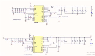

My customer is evaluating LM76005 in their new project, below is the schematic. Could you please help review and give some comments?
Vin 24V, Vout +-15V

What is the frequency?

Schematic looks good. See Section 8 in the datasheet for more Application and Implementation info
