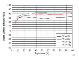

We want to drive 50mA 8 LEDs.The input voltage is 24V. Output would be around 27V and the drive strength does not differ, we keep it constant.
We are having troubles finding a driver thats highly efficient. The datasheets do rarely provide specific data. They usually give efficiency data at higher currents and we dont want it to drop down to some 60% at low currents as 50mA. Datasheets lack this data.
Do you have anything that you could recommend to us ? 85%-90% is considered ok but higher is better.
