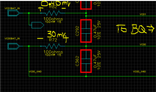

BQ79616-Q1: VC0 pin damage
Part Number: BQ79616-Q1
