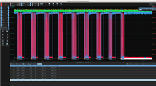

In our design, we have a TPS25750, and a BQ25713 connected to I2Cm of TPS.
After connecting a non-PD USB charger to the USB-C port, TPS sends an invalid write (partial write to ChargeCurrent, which is explicitly disallowed in section 9.5.1.8 of the datasheet for the charger). The end result of this is loss of communication with the charger. Below is a screenshot from an oscilloscope capture.

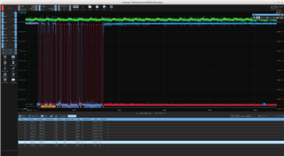

    here's the JSON, I'm also adding a screenshot with a closer look at the faulty frame.

  • Having talked with our EE, it seems that he mistakenly loaded only the lower region binary.
    We have now loaded the full binary into the EEPROM, but I can still the same faulty frame being sent.

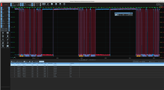

  • Conner,
    sadly, no luck. There's been little luck - we are still getting similar behavior.
    Although, I have noticed something I haven't noticed before: for whatever reason, when reading the DEVICE_INFO (0x2F) register, I am not getting TPS25750. The register returns the string:
    TPS65992 HW00A1 FWF509.05.61_0003 ZAceS
    Which seems to be weird. From what I could gather online, TPS65992 is not a public part. There was one repair video for a Dell Lattitude 7040 claiming in the title it has that IC.
    Anyway, strange ICs aside, I'm adding new screenshots, as well as a CSV of I2C frames.
    Jan

  • Conner,
    seems like third time's the charm, this time it works. Not with all PD sources, but it might just be the cheap stuff we're testing with).
