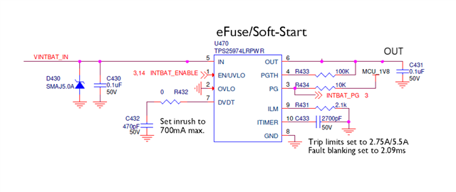

We are using the TPS25974L as shown in the circuit below:
We are running 2A through the circuit and I increase that to 2.8A. The eFuse trips within 100uS after the increase in loading. It should trip after 2ms.
Any suggestions why the eFuse is tripping early?

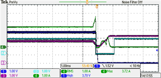

    Here is a scope capture. Not what you asked for but what I had on hand. I will take a better scope capture and send that.
    1 Dark blue = disregard - down stream DC-DC converter.
    2 Light blue = efuse PG output
    3 Purple = efuse output
    4 green = input current to efuse

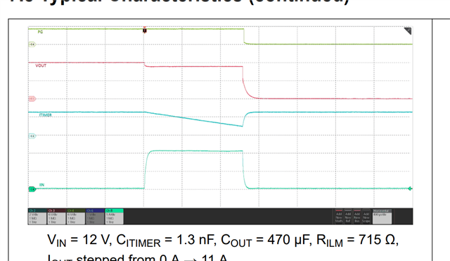

    2. Please share a waveform like below. Lets capture VIN also. Capture at instant when you switch load from below current limit to above current limit.
    3. From the waveform you shared looks like eFuse is not turning off because VOUT recovers. Looks like Load is turning off.
