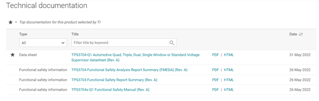

  • BTW, can you help to share me the FMEDA link or document?
    The text "Hardware capability up to ASIL A " means TPS3704-Q1 its self is a ASIL A rated device, additionally it can be used in a system in combination with other ASIL rated devices to reach a system level ASIL rating of D but using TPS3704-Q1 solely does not imply an ASIL D system.
    The functional safety documents can be found in the Technical Documentation section of the TPS3704-Q1 product page:
