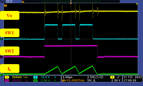

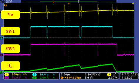

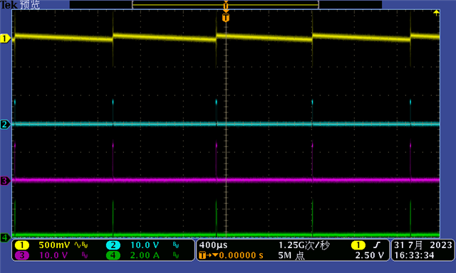

I tested some waveforms in PFM mode. For the pulse operation at switching times, I have few questions:
1. At buck, boost and buck-boost mode, the switching pulse seems to use the same period operation as PWM mode. Why don't use a long period logic to make IL and Vout increase continuously and quickly?
2. For now PFM mode, the switching time is about 3 periods. Is this fixed or determined by Vout?

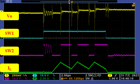

3. In picture 2, buck mode, the first switching pulse is ringing, what's the reason?
Could you please make any comments?
Thanks & best regards,
Arvin
Vin=8V, Vout=12V, Io=0A, PFM
Vin=12V, Vout=12V, Io=0A, PFM
Vin=14V, Vout=12V, Io=0A, PFM

  • Hi Arvin,
    Here are my comments.
    -> The duty cycle is still in control, and considering the loop response time, the effect should not differ much.
    -> It is not fixed, and can be determined by Vin, Vout, L, Cout, loading current and compensation parameters.
    -> When the MOSFET starts switching, it will first turn on the low side FET, and then ZCD is triggered, so the inductor is oscillating with the Cds of Buck FETs. It is normal operation waveforms.
    BRs,
    Bryce
