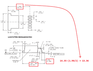

LP38503-ADJ: Dimensional deviation between package and LAND PATTERN RECOMMENDATION
Part Number: LP38503-ADJ
Dear Specialists,
My customer is considering LP38503TS-ADJ and has a question.
I would be grateful if you could advise.
I have a question about Land Pattern Recommendation of LP38503TS-ADJ
Land Pattern Recommendation is described P.12 of datasheet.
When the edge of the land and the edge of the tab are aligned, part of the lead (0.27mm) protrudes from the land.
Are the recommended land dimensions correct?
Could you please see attached PDF file below.
Question about LP38503TS-ADJ .pdf
I appreciate your great help in advance.
