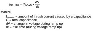

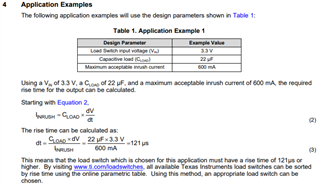

We would like to know what is the maximum acceptable value of output Cload.
Iinrush = ICL(Output current limit)
C = Cload
dV = Vout(NOM)*0.95
dt = tSTR(Startup time)

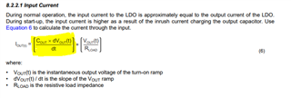

So, Cload = Iinrush current*dt/dV = ICL*Start time/Vout(NOM)*0.95 = 515mA*200us/(3.3*0.95)V = 32.85uF
Is my calculation method correct? Or will the start time change due to the Cload increase?

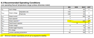

So if the Cload is greater than 1uF, I can't refer to this table. And should I refer to the Cout value on the Recommended Operating Conditions table? The Cload should be within 1~220uF. Is this correct?
