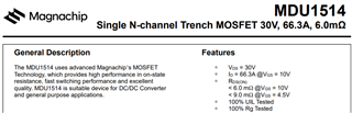

  • Hello Lumina,
    On QB1 and QB3 you are using the wrong MOSFETs, you are using P-channel MOSFETs instead of N-channel MOSFETS. I reccommend replacing them and check if this resolves the issue.
    Christian.
  • Hello Christian,
    The QB1 and QB3 are N-channel MOSFETS, not P-Channel MOSFETS.
    Is there any other suggestion?
    Kind Regards

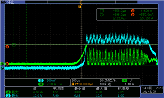

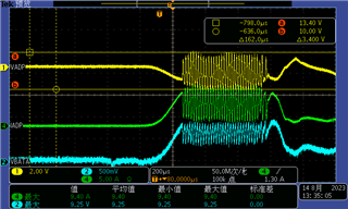

  • Hello Christian,
    Pls refer to the below for the waveform of the input signal:
    1) Normal charging waveform.
    2) Abnormal (battery in discharging state) charging waveform.
    3) Abnormal charging waveform when the adapter stars to power supply after dely 10s by pluged in the adapter.
    The system load is the operating power of the CPU at full power load, and the rated power of the CPU is only 6W.
    By the way, we also tried to add two 270uF/16V electrolytic capacitors to the VSYS output, but didn't work either. Our EC engineer also confirmed that the EC did not modify the register of the BQ24715 when the adapter was re-plugged in.
    Kind Regards
  • Hi Lumina,

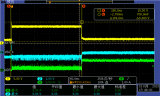

  • Hi Tiger,

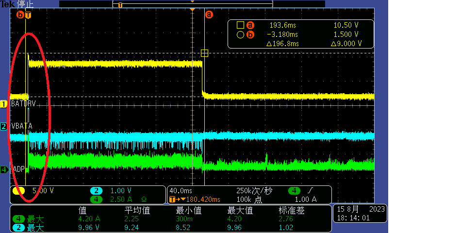

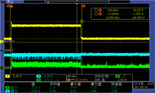

    We also measured the waveforms of BATDRV during normal charging (adapter power supply for the battery and the system load) and abnormal charging (adapter and battery power supply for the load) when the adapter is plugged in momentarily, and found that the voltage on VBATA(SRN) will be up to more than 104% of 8.7V (the max. charging voltage), the voltage on the BATDRV pin will be pulled up. The waveforms are shown below:
    1) Abnormal charging waveform
    2) Normal charging waveform
    From the waveform we can see that there will be a level change for the BATFET pin when the adapter re-inserted. But there will be two different charging states, the normal power supply of the adapter and the mixed power supply of the adapter and battery.
    Kind Regards
  • Hi Lumina,
    That is right, the BATFET will turn-off when BATOVP triggers. In this case, the BATFET gate voltage will rise since this is a PFET.

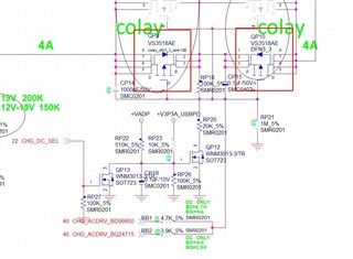

    Furthermore, I did not see ACFET/RBFET in the schematic. This FET together with BATFET provide a power path feature. It selects the power source for the system.
    Tiger
  • Hi Tiger,
    There is an ACFET/RBFEF on the circuit, and we are using the EC to control the ACFET/RBFEF, nstead of using the ACDRV pin of BQ24715 to control the MOSFET.
    Kind Regards
  • Hi Lumina,
    Please also look into the VBAT OVP when charging is first initialed. See red circle below. I don't expect VBAT to have a voltage jump if battery is connected.
    Tiger

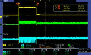

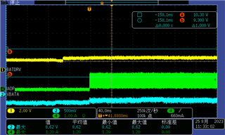

  • Hi Tiger,
    We replaced the BATFET with better parameters and re-plugged the adapter in heavy load mode at 96% and 100% battery power respectively, and found that both still in mixed power mode,which means the adapter and the battery are power for the system. The waveform are shown as below:
    1) Waveforms of re-plugged adapter at 96% battery power after replacing BATFET with better parameter.
    2) Waveforms of re-plugged adapter at 100% battery power after replacing BATFET with better parameter.
    As we can see from the waveform above, with the battery at 100%, unplugging the adapter and reconnecting it momentarily, the VBAT (voltage of the SRN) did not exceed 104% of the set output voltage (8.7V), and there was no trigger for the BAT OVP, but it still could not go into the normal power supply mode (the adapter's output current is about 0.4A).
    Kind Regards
