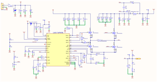

We have the Buck converter prototype board using LM5176, input voltage 24V and output 5V. while power ON the board we got the 5V output voltage without connecting any load .
But we have noticed that first MOSFET Q1 getting heating up and 24V input side drawing current almost 250mA.
Kindly find the below picture of reference schematic and let us know any update required in schematic or your suggestion to solve this issue.

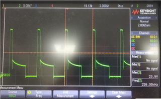

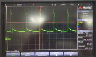

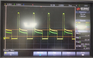

  • Hi Please find below the HDR1 and SW1 and 3rd is both complained screen shorts respectively. HDRV1 is not going down in OFF time almost 2V higher compare to SW1
  • Hi Shinod,
    i assume - please confirm.
    channel 1: HDRV
    channel 2: SW1
    The Buck highside FET Gate is referenced to SW1.
    So to open the MOSFET the Gate signal needs to be above SW1 with the at least gate threshold.
    So it looks like this MOSFET does not get a proper signal.
    Please also check the BOOT1 voltage.
     Stefan

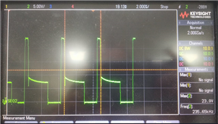

  • Hi Stefan, MOSFET ON signal seems proper  because we are getting 27V (t= 438nS). but I worried MOSFET OFF time during the OFF time we are getting 2V higher compared to SW1. kindly find below the Boot1 wave form for your reference looks ON time voltage is good (27V) for 22V input). Only Q1 is getting heated because of this Buck converter is loading at 250mA input current. Request you to verify schematic and components value, also Gaudi me why this issue ?

  • Hi Shinod,
    Sorry for the long delay and the e2e maintenance off-time.
    - The inductance used for this design is rather load. This lead to larger current ripple, which increases stress on the inductor and FETs.
    For this design, I would recommend to increase the inductance to at least 15uH.
    - The compensation might be improved as well. This would not affect DCM operation, but as the device is running in CCM permanent, it can improve the light load behavior as well. I would recommend to have at least 60 degree phase margin.
    If there is no change visible after making improvements here, we might also take a look at the layout.
    One more general question from my side:
    For Vin 23V-32V and Vout 5V, a buck-boost topology was chosen. Was there a reason you did not choose a pure Buck topology?
    Thanks and best regards,
    Niklas
