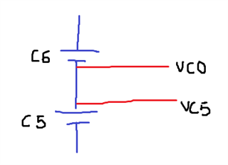

    I went through the layout guidelines for stacking BQ77915
    It says that the trace connecting the VC5 of a lower device to the cell should be separate from the trace connecting VC0 of the immediately upper device to the next cell
    Based on this, I've changed the connector configuration
    Pls advice which would be better for the device's performance, the new design or the previous one
    Schematic V6.1
    Muki

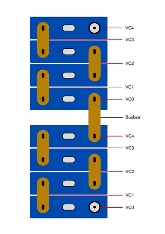

  • Hi Muki,
    What this guideline is referring to is the PCB layout. Your schematic will not reflect this, and you should add back the connections between each VDD and the above VSS.
    The guideline is saying that on the PCB layout VC5 and the above VC0 should have their own dedicated trace to the cell. See the image below. The red lines are the traces that you'll want for these cell connections, they're still electrically connected, which is why you won't want to alter your schematic, but they split into their own traces as soon as possible.
    Max Verboncoeur
  • Hey Max,
    Need a little clarification
    If this is the case, then the new design makes more sense. VC0 and VC4 traces will be split closest to the cell connection.
    They may not be connected in the PCB but they will still be electrically connected through the busbar
    I understand if this won't work, I'm just curious as to why
    Muki
  • Hi Muki,
    If they're electrically connected as you've indicated, then there is no issue. I recommended adding the connections back to the schematic so that it is clear that they are connected, however it is not necessary to do so.
    Max Verboncoeur
