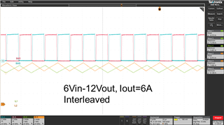

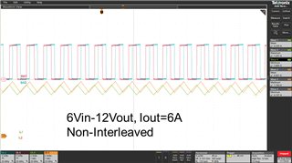

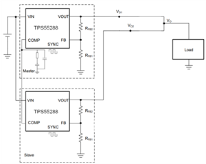

  • Hi Matthew,
    Sorry for late reply, our bandwidth is very limited recently. According to my bench test, when these two boards are connected in parallel, each board would take some loading current but the power sharing can't be realized since there is no external loop to regulate this.
    Below is the test schematic and test waveforms under interleaved and non-interleaved, 6Vin-12Vout/6A.
    External connection:
    1.Vin, Vout, GND are connected.
    2.FB pin: separate resistor divider.
    3.COMP pin: use single compensation network and connect together.
    4.SYNC pin: can use external PWM signals(phase shift 180°) for interleave operation.
    BRs,
    Bryce
