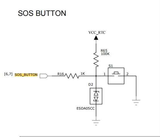

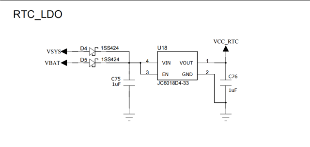

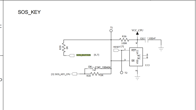

  • Hi Anthony,
    I cant give all the schematic,but i could give you the part of the bq21080 chip.Wish that is enough for you.
    These are the pictures :
    Angelo Zhu
  • Hi Anthony,
    You can see that I connected the TS/MR pin to a button , but i found that this pin keep giving me a pulse which will make my mcu keep getting the button interrupt,so I removed the R39 resistance in the SOS button picture .

  • Hi Angelo,
    1.Does the TS/MR always give the pulse that i cant control?
    Yes, the TS/MR will have a DC signal when VIN is present and will pulse when VIN is not present but battery is present.
    2.Can I use this pin to connect a button for other purposes,and i can also use this button to hardware reset the chip?
    You can use it for three functions that you can find here:
    If you are looking for a way read the push button with your microcontroller, it's recommend to use a circuit that does not interfere with the behavior of the push button such as the following:
    It's also important to note that if you are not planning on using the TS feature of the TS/MR pin, to disable the TS function or have a 10k resistor from the TS/MR pin to GND. You can disable it by modifying the following bit if you are unable to add a 10k resistor pulldown
