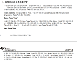

For high rate discharge application,How do we configure Prime Relax Time, Sec. Relax Time and Res Relax Time in data flash?I don't know where I can set them.
Hello Lion,
The GPCRB tool will update these parameters for you. Please follow the user guide and copy the reported gg file (see below for an example report from the tool).
