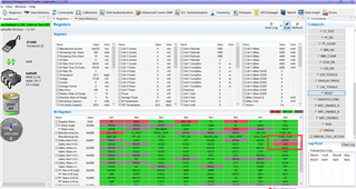

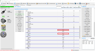

问题一:BQstudio软件与保护板连接好后,更新完固件后的默认温度保护参数为什么会超出最小限制以及默认值的温度如2185.5度这些值不符合常理?
问题二:设置温度保护参数时,设置OTC小于45度时,会发生欠压保护,这是什么原因?
Please make sure you use the correct BQZ file for the device, if it is not auto-detected and you are manually selecting the BQZ this can cause data corruption and bit mis-alignment.
Sincerely,
Wyatt Keller
