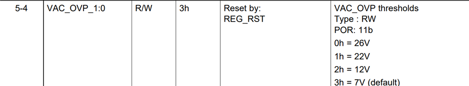

    BQ25790 has input OVP set to 7V.  If your input voltage is higher than 7V and you use the input MUX fets, you need to add a line of code that increases the OVP.  The register is REG0x10[5:4] as shown below:
    Other than that, the BQ25792 linux driver should work for the BQ25790 because the registers are the same.

    In my driver the BQ25790_CHRG_CTRL_1 0x85 register is configured for 26V by default. And the input required for my Hw is 5V.

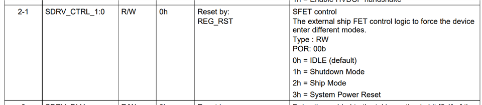

    There are no registers required for the battery to supply a voltage at SYS.  If there is shipFET between the BAT and battery, the SDRV automatically turns on by default.  With or without a shipFET, the internal BATFET from BAT to SYS turns on by default.  Is it possible that the driver code automatically puts the charger into ship or shutdown mode when input is removed?  Can you check to see if REG0x11[2:1] are being written

    In my driver code the SDRV_CTRL register is set to 0h in IDLE mode itself, the Hw is booting through the external supply with battery connected to the IC as soon as I remove the supply the battery works but not booting with connected individually without external supply.
