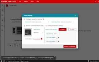

I try to reprogram an already mounted TPS6594 with the TPS6594EVM. As a small test I tried to reprogram the PMIC which is located on the EVM, but currently fail with the following error.
I currently would assume that the programmer can’t locate the PMIC at the address 0x48, which should be the default I2C address (?). So maybe you have an idea what I do wrong?
The EVM itself is unchanged and connected via USB Type-C to the PC and via 5V to a power supply.

  • This inquire originates from me, so I would like to response to this. Yes I did tried other ones, in the first steps it was actually attached to a different board, as a solution to reprogramm a PMIC with an older firmware. Ti provided a guide to do so, but failed aswell. Thats why I reversed the change and tried with the on board chip. This also fails with 0x28 or 0x2C.
    But isn't the default address 0x48? At least this is what I saw in the datasheet.

  • Sure. Currently I have a TPS65941111EVM. Here I just noticed, that the Jumpers J47 and J37 are placed on the "Slave" position. I also noticed, that the board is kind of not featured in the EVM manuel (maybe an older version of it).I would guess, that this should be on the "Master" position. Should I set both to that?
    I2C seams pretty alive,

    Yes, please move both of these jumpers into the master position & provide a 3V3 source via the jumper or in the J6 power block.
    Try to reconnect to the address of 0x4C, on this NVM that is the base address.
    As for the screen shot, there is data going over the line from the MCU onboard to speak to the PMIC, but since the base address is not correct there is no ACK from the PMIC. Excuse the screenshot below, The first 7 bits are the base address, 8th is R/W, 9th clock/bit is the ACK, since it is held high there is no acknowledgement from the PMIC.

    But this worked for me. Thanks!
