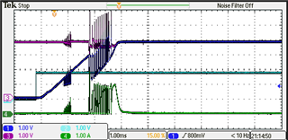

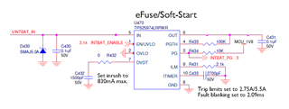

We are using the TPS25974L in the circuit shown below:
The output of the eFuse is connected to circuitry that includes 380uF of capacitance.
When the eFuse is enabled we see a current spike that looks excessive:
Dark blue = ITIMER pin 10, light blue = dv/dt pin 7, purple = output voltage pin 6, green = input current
The current spikes to approx 3A for a short time. My understanding is the eFuse should hold the current to under 830mA with these component values.
Is this correct operation?

    This is part of a battery powered system and the inrush current control (dv/dt - pin7) of the eFuse is being used to control a turn on current surge from the battery.
  • Hi Rob,
    eFuse is controlling VOUT slew rate. So current through eFuse is cap charging current +LOAD current. Cap charging current is COUT*dv/dt= 830mA. eFuse will allow current upto ILIM.

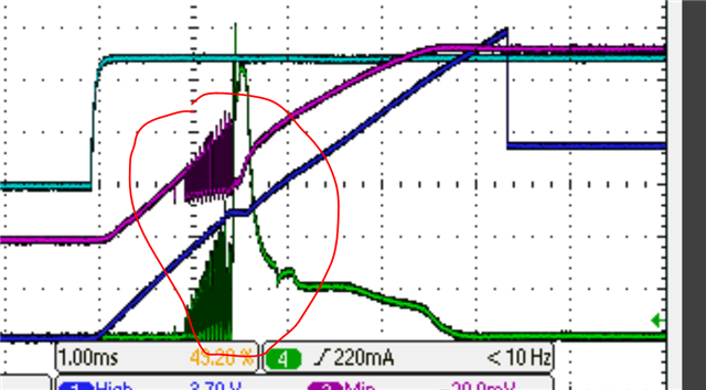

  • Hi Kunal,
    I agree, something weird is happening in the plot I sent. I checked my probes and connections and they are all good.

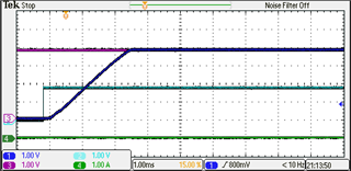

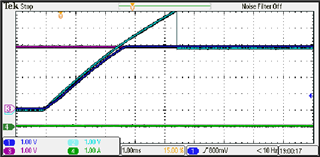

    Here are additional scope captures that you requested. In the following scope captures the dark blue = VOUT, purple = VIN, light blue = dvdt, green = input current. In the second capture the light blue = EN
    This is with no input cap and the output isolated from all other devices. There is only a .1uF on the output.
    This is with adding 330uF cap to output.
    This is connected to the TPS63811 buck-boost converter. I verified that the TPS63811 is disabled at the time that the eFuse is enabled.
    While it is obvious that the addition of the TPS63811 is causing the issue, it is not obvious why the eFuse is not doing a better job of limiting the inrush current. As we have the circuit setup per datasheet formulas, I am thinking the eFuse should hold the current spikes to under 1A.

  • Hi Rob,
    Dvdt behavior is fine. It will go above VIN level. Your current limit is 2.75A so eFuse will limit below it .
    Limiting to 830mA is valid when load is capactive in that case current through eFuse will go though cap only.
    IeFuse= C*DV/DT= Constant at 830mA
    But in your case dc-dc is also drawing current so eFuse has to support both cap and dc-dc.
    IeFuse= C*DV/DT+ ILOADDC_DC <=ILIM

  • Hi Rob,
    You are correct on understanding. But we have both inrush current control and current limit during startup also. Inrush current control is ramping up FET gate with a controlled slew rate. It is a source follower. VOUT will follow gate slew rate. Now current through eFuse is (VOUT/RLOAD + COUT*dv/dt). If load current crosses current limit eFuse will limit it. Current limit has a response time of 465us. So if current peak is less than 465us then device might not limit it.
    I think since current peaks in your case are less than 100us so eFuse might not be limiting them.
    I think some path in buck-boost is getting enabled. We also need to see if we can disable that path while eFuse is starting up.
    Kunal Goel
