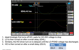

Question 1: Vgs turns hi already, but the Vds still kept hi, too. It makes me have poor efficiency and superheat. If TI experts can help me out with this, I will appreciate it.

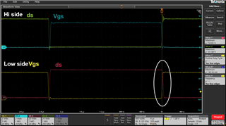

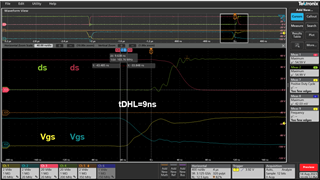

Question 2: I noticed the tDHL in spec needs 20ns at least. However, I overlap the Hi side and low side gs signal and the measured value is 9.1ns. I have no idea if it is correct. (waveform2) The phenomenon doesn't show up on the hi side mosfet turning on. (waveform3)
Thanks a lot ~

    Question 1: The schematic shows that there are 10 Ohm resistors at each gate. These might be to high, which affects the discharge of the FETs, leading to a lower actual dead-time than regulated by the device.
    I would recommend to reduce the gate resistance of both FETs to max 5 Ohms and check if the behavior improves.
    Questions 2: Are you measuring the gate voltages directly at the FET, or directly at the IC pin?
    If the measurement was taken at the FET, it can show that the dead-time is lower, as the low side FET is not fully discharged due to the voltage drop at the gate resistor, while the high side FET already turns on.
    To clarify this, you can make a measurement directly at the IC pin and check if the dead-times are like specified in the datasheet.

    Question 1: All of the measurements are tested at FET directly. I tried the 4.4ohm even lower value resistor on my circuit, but the system became unstable. If any solution can improve this problem I will be grateful.
    Question 2:The photo below shows the measurement at LM5123EVM-BST, with a slight overlap at gs and ds, even when using 0ohm. It's unclear if only the measurements on the IC side and FET side differ.
