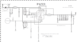

Which model is the light-load high-efficiency curve of LM61460 tested on?
The customer's test output VOUT=4V, Iout=6.4mA; input Vin=12V, Iin=6.1mA, switching frequency 1.911MHZ, so the efficiency is about 50%?
The model used by the customer is LM61460AASQRJRRQ1
The inductor selection is SUNLORD's AMWSA0603S-4R7MT
Schematic diagram:
    The efficiency curve for the AUTO mode device should have been on the LM61460EVM-AS-400K evaluation kit which is using the LM61460AASQRJRRQ1 IC.
    How is your efficiency bench connected? In the case where you are measuring efficiency at this light of a load, it is okay to not have the power supply remote sense connected at the input of the EVM as this might draw current and corrupt the input current data.
