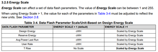

    Regardless, I also have two questions regarding to the design energy register.
    1. I see in the release notes that specific feature has been enabled only in bq34z100-R2 v2.01 build 26, and as such it is missing in the data flash description table in SLUUCO5 (see screenshot below). Could you clarify the min/max value of the register so that I know the range I have to scale for?
    2. Regarding the units of the design energy register, SLUUCO5 mentions in section 3.2.5 and 3.8 that energy is reported in cWh, see image below.
      However, when I look in the dataflash using BQStudio, the BQ34Z100-R2 indicates units are mWh, which means I need to increase my energy scale factor. See image below.
      Could you confirm if the design energy units in R2 v2.02 are cWh or mWh such that I can scale the system energy correctly?
  •     The min/max value for the Design Capacity in Dataflash is 0 to 32767mAh, but it can be scaled with current scale factor, which ranges from 1 to 255.
        The unit of Design Energy is actually cWh, mWh is a typo in bqStudio.
  • I was looking for the min/max value of the Design Energy in Dataflash, I'm assuming it will be 0 to 32767 cWh and is scaled with the Energy Scale factor similar to design capacity and current scale, but can you confirm if that assumption is correct?
  •     Yes, it is the same as Design Capacity, and this parameter is already made visible in the latest TRM, you can check to download from the website.

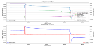

    I did some further testing of the gauge for "convergence behaviour" to try and see how the gauge handles being mounted on a pack with unknown SoC during production. I see that the gauge starts taking increasing DOD measurements (purple) during the long relaxation period, and keeps reducing the remaining capacity (green) as a result.
    There is no current detected, hence the integrated charge not changing, so I think this is purely caused by the voltage relaxation. Normally, the remaining capacity should not change as the battery is not discharging, and especially not this much (battery SoC drifts from 100% at end of charge to 67% at end of relaxation).
    Considering your input above that the chemical profile might be incorrect (I am still using profile 400), is this expected behaviour in a system where the chemical profile does not properly match the cell in use? Is cell relaxation behaviour taken into account for generating the different chemical profiles such that the DoD does not start increasing when the cell relaxes if the correct chemical profile is used?
    Logging data is attached for reference:Initial_Convergence_testing_on_2nd_board.log
  • The voltage looks problematic in relax. Please make sure that you enable option LFPRelax in OpConfigB, which will force a 48 hour timeout in relax before the gauge attempts to adjust DOD0 by OCV.
    Your battery's voltage behavior in relax is concerning as it keeps dropping well past 48 hours, which is suspicious for an unaccounted current drain on your battery. Given the flat OCV curve for ChemID 400, the gauge will adjust DOD0 (as shown in your log file) and therefore it will change RM and SOC. So the question is, why does the battery voltage keep dropping without a current?

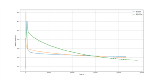

  • I have spent the weekend monitoring our other LFP batteries for their relaxation behaviour, see attached picture.
    The trace in green is the battery I have been testing the fuel gauge against for the duration of this thread, the ones in blue and yellow are a 105 Ah LFP battery and a 5 Ah LFP battery that contains the chemID 400 cells respectively.
    Although the relaxation behaviour is indeed very different from the battery I have used for testing up until now, I still see some slope in the battery voltage past 48 hours (though noticeably less). Can you confirm if such levels of relaxation are acceptable or not?
  • LiFePO4 in general are challenging. The IT algorithm uses a 48 hour timeout if the cells aren't charged high enough before using a voltage reading for this reason. The blue and yellow line show only a slight change in voltage after 48 hours, which, while not ideal, is going to work much better than the original chemistry.
