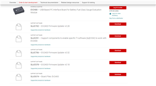

Also, i have EV2400 with firmware version 0.18. What version should i install it from website because there are 3 versions available? what's the difference?

    The downloadable firmware updater versions for the EV2400 are based on improvements and bug fixes that have been added over time, with v0.32 being the most recent and v0.18 being the least recent.

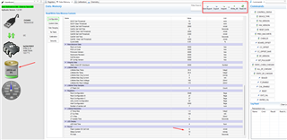

  • Hi
    I followed all your steps except when i opened the BQstudio(point3) it wasn't showing me applied voltage that i applied at BAT pin directly i.e2.5V
    What i did, calibrate the voltages to 2500mV according to the video and it start showing the applied voltage.
    Next i followed all your steps and it started working to show me voltages as i increased on supply voltages i.e. 10V

  • Hi Ali,
    If the dashboard on bqStudio is showing the correct value after the calibration steps have been taken with your battery pack attached, then it was successful. To avoid doing the calibration steps again, the .SREC files can be downloaded from the Golden Image tab of bqStudio to get a copy of the image, and can be reloaded using the Programming tab of bqStudio.
    Since the settings have been written onto this device, the settings will remain even if it is depowered.

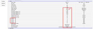

    3. The battery that i am using has 2.5Ah cell in 7S1P configuration. The total energy is 63Wh but i couldn't add it's value in the desire box
    4. I also noticed that now with some settings, the gauge now showing 7% of battery power even if i am applying 25V through power supply. The nominal voltages of the battery are 25.2V

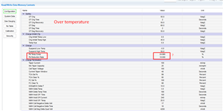

    1. For the Pb Temp Comp and Pb Reduction Rate values, there seems to be an issue with the values we have in the Technical Reference Manual. We believe the values you have there should be fine.

    3. We believe that this design energy value should not be changed unless you are planning to constant power load and change the load mode to 1.
    4. Since a learning cycle has not been preformed for this battery yet, this is fine. Once all the processes have been completed for this battery, bqStudio will show the correct value.
