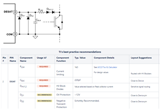

would you recommend to use DESAT protection of UCC21756 for SiC moduls? In some other posts were the recommendation to use OC protection instead of DESAT? We want to avoid false trigger. Have you any recommendations for DESAT voltage? Would you recommend to implement additional protection diode between DESAT and GND as well as charge resistor between DESAT and OUT?
