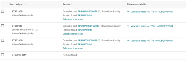

Can you suggest some alternate TI P/N for the below infineon P/N
BTS716GB
BTS50010-1TAE
BTS7002-1EPP
BTS716GB
We did not need the exact TI part.
Only thing is current rating would be same.

Hari,
You can use the cross reference search tool for this sort of task here:
https://www.ti.com/cross-reference-search
I plugged in the results here:
For BTS7002-1EPP, the best match for a TI part would be a gate driver such as TPS1211-Q1.
