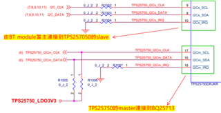

1. Is the I2C connection of the TPS25750D correct?

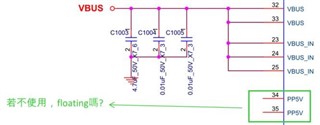

2. Recommended voltage for VIN_3V3 (pin 38) of the TPS25750D
3. Is the power supply of TPS25750D OK? Does PP5V not use direct floating?

  • 1. Is the I2C connection of the TPS25750D correct?
    Yes
    Yes

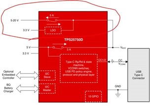

    Based on Q4, if you want DRP support, then you need 5V supplied to this pin. This is what provides Vconn and CC voltages.
    how should it notify BQ25713 to change the charge and discharge? Should it notify TPS25750 PD controller through I2C?
    TPS25750 does not support multi-master mode so you cannot notify directly. You can use 4CC commands such as 'I2Cw' to indirectly write to the BQ25713 part or BT module can modify the Transmit Source register (0x32) and resend the Source caps using 4CC commands 'SSrC'.
