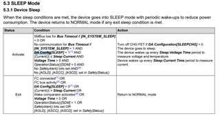

    Conditions to enter and exit Sleep Mode:
    Note: The device does not perform any protections during SLEEP mode. It will transition to NORMAL mode after the conditions have been met, and then perform the OCD protection if qualifies. In seep mode, the DSG is OFF and the CHG is OFF if DA Configuration[SLEEPCHG] = 0.
    Once the device is in SLEEP mode, it will wake up every Sleep:Voltage Time period to measure voltage and temperature and  every Sleep:Current Time period to measure current. Check the settings for these two parameters.

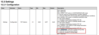

  • Hi Star,
    The CHG FET should remain ON during sleep mode for current to be sensed in the sense resistor. Make sure SLEEPCHG is set (see below). This will allow charging current to flow during Sleep mode.

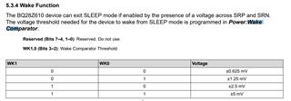

    As stated in the above picture, two of the conditions for the gauge to exit sleep mode is:
    1- if the current() (sensed) > sleep current threshold
    2- if  wake comparator activates.
    I believe you are referring to the wake comparator option. If so, correct. The device will wake up if the voltage across the SRP and SRN pins exceed +/- 0.625 mV when Power: Wake Comparator is set to WK1:WK0 [00]
