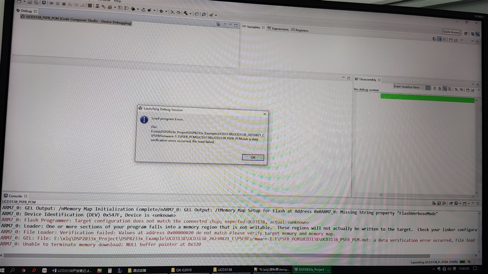

Debugging Environment.
Control board is UCD3138CC64EVM-030
Emulator is XDS100v2
IDE for ccs8.0
The program is in the TI official website to download the UCD3138 phase-shifting full-bridge firmware code, through the ccs imported, compiled through. Connected to the emulator, the emulator connection test passed. However, after connecting the emulator can not burn the program, can not be online debugging, see this error message is to identify the chip is unknown and expectations are not the same.
Please see the attached image for the error report.
