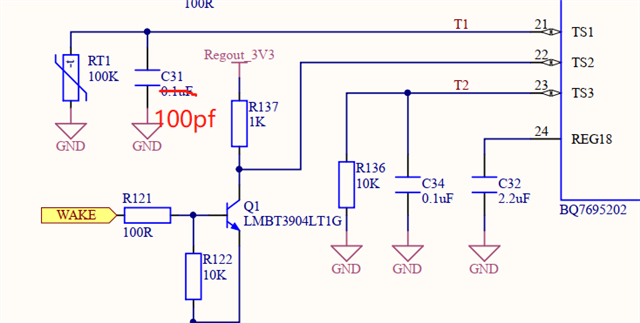

Hi
The NTC used is CWF1_ There is a difference between the B value  and the default 18k temperature model, so I used the relationship between the resistance value and temperature of CWF1_10KF3950 is generated using TI's online tool to generate calibration coefficients, but the temperature read out is 127 ℃.
Attachmed  NTC specifications and the generated calibration parameters

  • Hi Star,
    Your settings appear to be correct. This may be a hardware issue.
    Could you provide your schematic for review?
    Max Verboncoeur
  • Hi Max
    Thanks for your reply.
    Attached the schematic for your reference.
    Star
  • Hi Star,
    Your schematic seems fine. Just to confirm whether this is an issue with the ADC calculation or with the actual hardware, can you provide the raw ADC measurements from while the device is exhibiting this behavior?

  • Hi Star,
    It looks like the ADC is reading ~0.545V, which, assuming an ideal 18k pull-up resistor, translates to ~7.8kohms on the thermistor. Looking at your thermistor curve that's 30~31ºC, so we can be quite certain that this is not a hardware issue.
    I recommend taking a look at the example code provided on the BQ76952 product page and seeing if using those functions has any difference on the reading.
