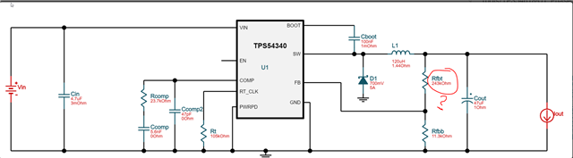

I setup a Webench design with the following input parameters:
Vin: 22V to 29V, Iout: 200mA, Vout: 10V, target frequency: 0.936MHz. The following output is generated on Webench:
When I use the datasheet formulas to verify Rcomp, Ccomp, and Ccomp2, the suggested values are very different from what the datasheet equation suggests:
Rcomp: 6.57k (equation) vs. 23.7k (Webench)
Ccomp: 653nF (equation) vs. 5.6nF (Webench)
Ccomp2: 1983pF (equation) vs. 47pF (Webench)
I verified that my equations are correct as I tried out the datasheet example and I got the correct data sheet answers.
Can you please help me understand why Webbench suggest such a different solution, and how to resolve the discrepancy? Much thanks!
