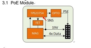

Customer has a project to use POE power supply module, there is TPS23754 in the block diagram. Customer has never used this kind of POE power supply module before, would like to ask how to connect with the system?Thanks!!!

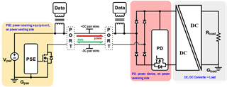

The PoE can provide DC Power over same Category 5 twisted-pair cable that carries Ethernet data, like the below two pictures.
The power device (PD) TPS23754 has an internal MOSFET as hotswap and PWM controller. You can take a look at TPS23754EVM-420 (https://www.ti.com/tool/TPS23754EVM-420) and TPS23754EVM-420 (https://www.ti.com/tool/TPS23754EVM-383) for detailed circuit information.
