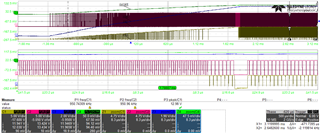

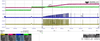

hello,
TPS552882-Q1 Why is it always buck first and then boost in buck-Boost mode?
In theory, when VIN<VOUT, should be boost first, then buck; When VIN>VOUT, it should be buck first and then boost.
Waveform as follows:
The waveform at 9.8V
The waveform at 13V
  • Hi Seven,
    When exiting skip mode and starts switching, the first cycle would be Buck high-side on and Boost low-side on. It is not decided by Buck or Boost mode.

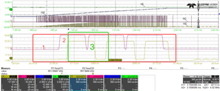

  • Hi Bryce,
    Thank you very much.As shown in the figure, what number does this first cycle correspond to in the graph? How can I explain the three serial numbers of my marked?
  • Hi Seven,
    The '1' phase is still the skip phase which is non switching phase. The '2' phase is the first cycle I meant, Buck high-side on and Boost low-side on. The '3' phase is Buck high-side on and Boost high-side on. You can probe the inductor current waveform for better understanding.
    BRs,
    Bryce
  • Hi Bryce,
    So four swithchings are off in the '1' phase,right?
  • Hi seven,
    Yes, no switching in phase 1.

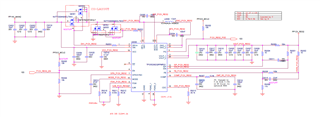

  • Hi Bryce,
    The question I asked you about TPS552882 is because there are two cases of TPS552882QRPMRQ1 burning problem. The investigation found that the high-side and low-side MOSFET of the chip were burned, and the two external MOS were also burned.
    The schematic diagram is as follows:
    Can you give me some clues about this failure?Or what will cause MOSFETs to burn?
    Thank you for your help very much.
  • Hi Seven,
    1. May I know what is the application and product type here?
    2. What is the input voltage range, output voltage range and max output current?
    3. Do you have the part number of the output caps(C9305-C9308)?
    4. Can you also share with your layout?
    BRs,
    Bryce

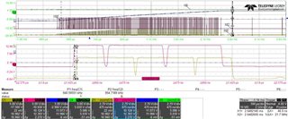

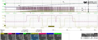

  • Hi Seven,
    Thanks for feedback, since PFM is enabled, the zero-crossing function is always on during all the operation period, and there will be no negative current, so I don't think this can be the same reason as before.
    For this case, can you help do some test and probe some waveforms of the startup and load transient?
    BRs,
    Bryce
  • Hi Brycle,
    I would be happy to provide some test waveforms.
    Light load:
    heavy load:
    From these waveforms, it seems to be fine, but unfortunately, this failure occurred. Do you have any good ideas to help me reproduce the faulty waveform?
