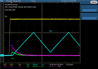

We are working with TPS1641 evaluation board and getting unexpected results. Can someone review the information below and provide debug guidance?
I am using the TPS14612 side with all jumpers set at default.
There are other issues I’m currently analyzing, but one concern is startup into a load.
Below is a startup into a 1A (24ohm) load. As you can see it is hiccupping. Voltage on the IDLY pin seem to indicate the fault timer is started. A 1A load is well below the Ilimit currently set to 1.8A. Experimentally, I can start up at loads <0.5A. Can you explain this?
Thanks for your help!
Jim B
  • Hi Jim,
    I think device is hitting thermal shutdown due to high power dissipation across internal FET . During startup of eFuse due to high VDS and IDS(load current ) stress thus causing high power dissipation will cause FET junction temp to rise and when temp reaches near a threshold device will turn off.
    That IDLY pulse is due to retry timer implementation. After thermal shutdown device will retry after a timer.
    This is expected behavior of device.

  • Hi Kunal
    What is the recommended change if we want to start up into a 24 ohm (1A at 24V input voltage) load?
    Will changing the slew rate setting help?
    Or do we need to select a different TI product?

  • Hi Jim,
    Are they using CC load? I will recommend using CR load because actual loads are more like CR. Increasing slew rate by decreasing dvdt cap can help.
    What is the actual application load? I dont think it will be a load that will draw 1A at 0V. Every load will have some turn on threshold.
    Kunal Goel
  • Hi Kunal
    As shown in the plot above, the test load is resistive, 24 ohms. In the image the current only ramps up to around 200-250mA (voltage around 5.25V)  before it starts to fall.
    I will get more details on the actual application load.
