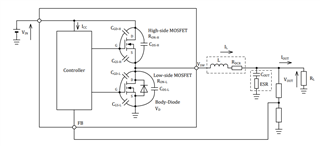

Your question is not very clear, but i am assuming you are asking about the power losses between the inductor and MOSFT. the power losses can be estimated as I2R where R for the MOSFET is the RDSON and the inductor is DCR. This is very simplistic as much more losses are is contributing the efficiency and losses
The following factors can contribute to power loss:
1. Conduction loss caused by the on-resistance of the MOSFET
2. Switching-loss in the MOSFET
3. Reverse recovery loss in the body diode ܲ
4. Output capacitance loss in the MOSFET
5. Dead time loss ܲ
6. Gate charge loss in the MOSFET ܲ
7. Operation loss caused by the IC control circuit
8. Conduction loss in the inductor ܲ
9. Loss in the capacitor

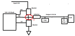

Thanks, I have added a example image , so that it will be easy to understand.
As per image, the input voltage is 12V and Output voltage is 3.3V with 2A.
Consider Buck convertor efficiency is 100%, so Pi=Pout, then Iin= (3.3*2)/12 = 0.5A
Till now, input current is 0.5A, output current is 2A, so what will be the current between the input and output, means between the mosfet and inductor.
I have marked it in red colour. Whether it will be same as input current or output current.
Also, for PI simulation whether we need to consider the inductor as source or mosfet/buck convertor output pin as source.
The current on the red circle is called Inductor current that will be charging up when the High Side FET is ON and going down when the Low Side FET is ON.
