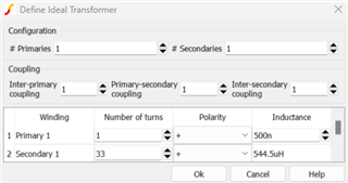

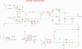

I am designing an LLC DC-DC converter using the UCC256403. Input voltage of 13.6V nominal with a 500V output.

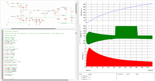

When I run the Simplis simulation, I'm getting very high input currents from my DC source and values at Isns that are way above the 4V threshold. I included some snapshots below. I also included my command window values below.
Does the UCC25640x Simplis model have OCP capability? It seems like when I try to adjust the values of Cisns and Risns, it has no change on my outputs. With the current values listed below, I should see a pk-pk on Vcr of ~4V and a peak of 12A @ OCP1 when Visns hits 4V. However, you can see from the figures below that we are nowhere close to those values.
Another question: in the example provided, there are two inductors to emulate the leakage inductance and a separate inductance for the magnetizing inductance. In my model, I went to 1 inductor for the leakage inductance and integrated the magnetizing inductance into the transformer model as the primary side inductance. Is there any reason this shouldn't work?
Thank you in advance for the help, and please let me know if I need to provide more information.
